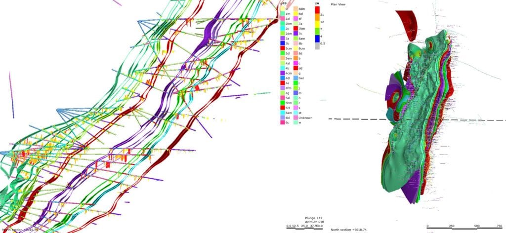

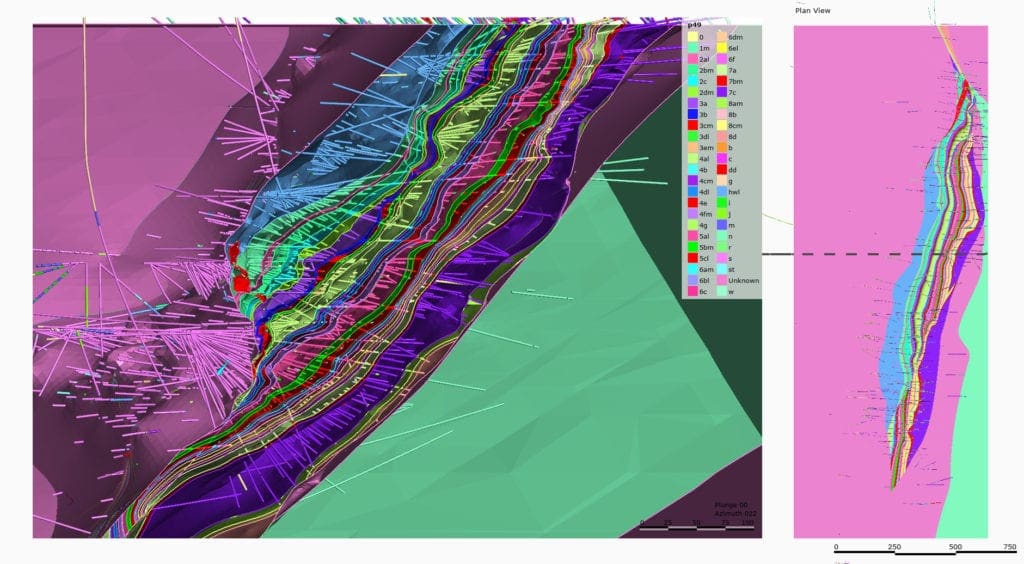

Figure 1: Glencore_P49 model
Figure 2: Leapfrog assays

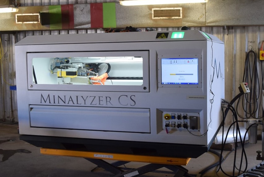

Glencore introduced the Minalyzer CS drill core scanner for on-site geochemical analysis of drill core. They combined this with Seequent’s Leapfrog Geo modelling software (which was already in use at GFM). With the addition of the Minalyzer, their workflow is as follows:

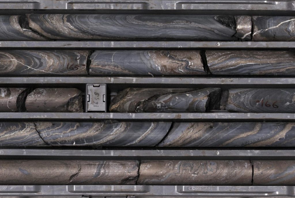

  1. The core is scanned in the coreshed by the Minalyzer CS, producing very fine-scale geochemical analysis in 10 cm intervals.
  2. The core is then logged, with the assay data from the Minalyzer CS assisting domaining of units, primarily through identification of the high potassium TMBs. This highly detailed analytical data allows for improved domaining through better identification of domains when logging.

  4. Newly scanned and composited XRF and logging data is imported or reloaded into the Drillhole Database of Leapfrog Geo, as either a csv file or via the ODBC link. Underground pit mapping and structural measurements can also be appended to this data.
  5. The metamorphosed zinc-lead-silver stratiform deposit is modelled in Leapfrog Geo using the stratigraphic sequence tool, and the Fault System is used to model the N-S trending sub-vertical faults that cross-cut the deposit.
    • The implicit nature of these surfaces and resulting models mean that Leapfrog Geo will re-run and update when new data is added to the inputs. This means new logged data from the Minalyzer CS is reflected in the model with minimal effort.
  6. Drillhole data is updated from the Minalyzer CS and validated daily, with results available in 3D within Leapfrog Geo.
  7. These are then used to produce an updated geological model in just a few hours, with the latest wireframes exported to Deswik for blast engineers and mine planners.

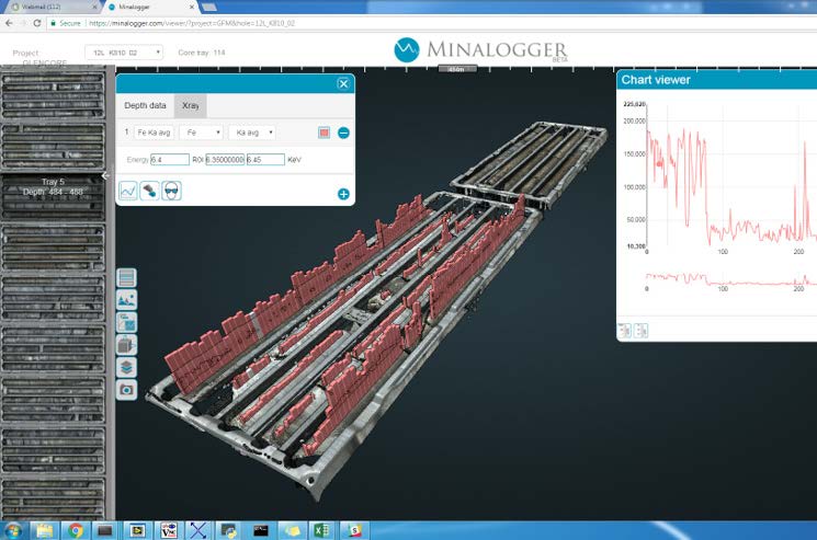

  1. In Leapfrog Geo, drillhole tables support columns of URLs, which can link to internet-hosted data or file paths for local data. Minalyze modified the software in Minalyze CS to produce an additional URL tag for each logged interval.
  2. This URL points to the logged data within the Minalogger web-hosted coretray viewer.
  3. This URL is imported into Leapfrog Geo, along with the geochemical logging. Leapfrog Geo users can select drilling in 3D, and choose to follow the URL to view what the original core looked like during the Minalyze scan. The Minalogger tool presents a high-resolution scan of the core as well as overlays for all geochemical mapping.
Easy access to this information during the domaining process helps validate logging, and identify errors before they propagate too far along the process.

Minalogger
Pairing the Minalyze workflow with Leapfrog Geo allows for up to date models within hours, as opposed to standard processes with results not available for weeks or months. The immediacy of data interpretation by geologists and the subsequent use by blast engineers and mine planners results in better decisions being made faster, increasing efficiency of resource utilisation.

Figure 3: Glencore_P49 assay domains
