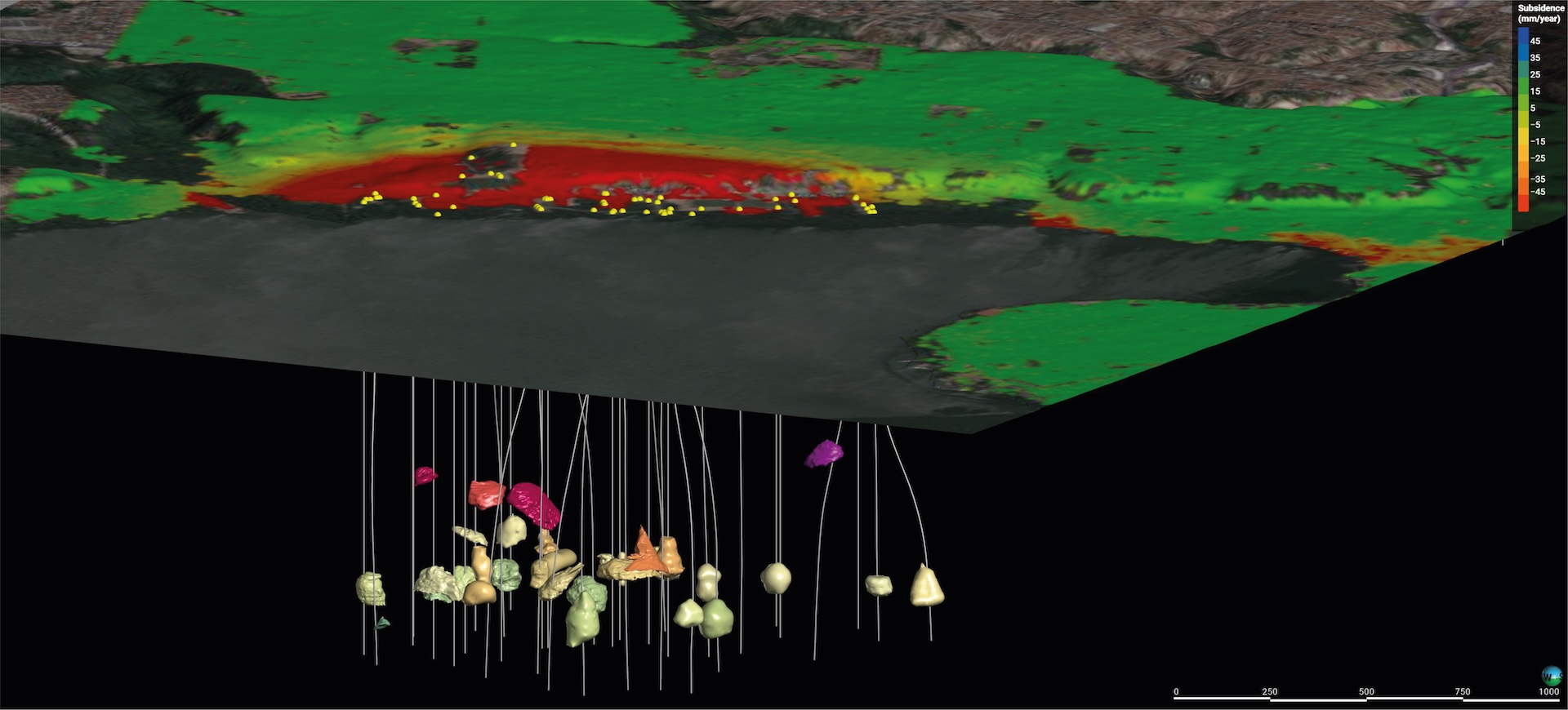

The subsidence map shows that the areas most affected by the lowering of the ground are positioned exactly over the cavities produced by salt mining. The subsidence recorded in these areas is greater than 45 mm per year.

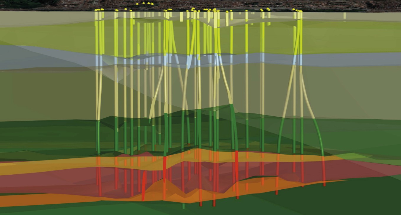

This is a three-dimensional geological model where the evaporite (salt) layer has been highlighted. The model has been constructed using boreholes that were designed for salt mining purposes.
The project team developed a groundbreaking methodology to build a 3D model of the salt-mine cavities. They used historical sonar survey data, georeferencing the images within Leapfrog. By digitising cross-sections from multiple angles, they constructed 127 detailed 3D solids representing each salt mine.
