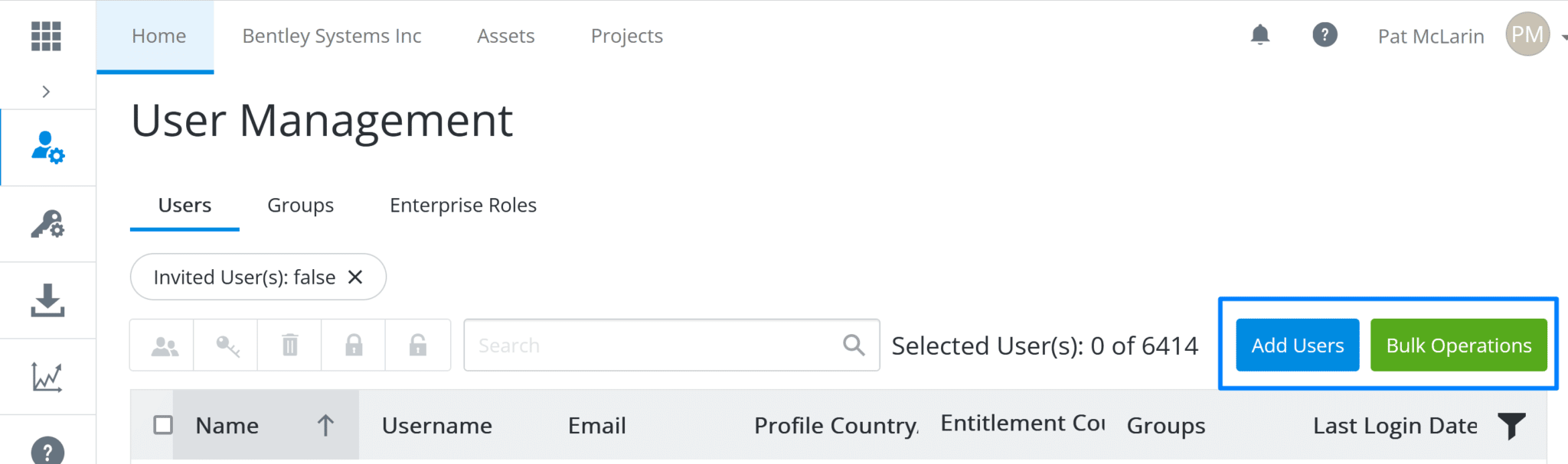

1. Bentley user administration set up
- Go to Bentley User Management
- Select Add Users or Bulk Operation
- If your organisation uses active directory federation with Bentley user management, your users will automatically be added, and you can skip this step.
![](https://www.seequent.com/wp-content/uploads/User-management.png)
- Complete the details for any new users or upload a file with multiple users for bulk changes

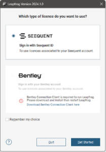

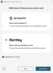

- New users will be emailed when the administrator adds them to their organisational account from both Bentley and Seequent systems, prompting them to complete their Bentley Account set up and to create a Seequent ID.
- Install the software following your organisation’s policy. If you need access to the installer, it is available from the Seequent product page.
- Please note that Leapfrog is NOT available for download in the Bentley Connection Center.
- Sign into Leapfrog Works using your Bentley User Account.
- If you don’t have a Bentley User Account, create one here.
- Make sure the Admin then adds user to E365 Organisation on Bentley User Management, as per the above instructions.
![](https://www.seequent.com/wp-content/uploads/GIF-Login-screen.gif)
- New users will also be sent introductory emails from Seequent with helpful information and resources to get them up and running with the Leapfrog Works software.
- Regardless of whether you sign in with a Bentley account or Seequent ID, the Seequent Connector app will be installed and utilised to manage your connection, independent of the Bentley connection client which may also be installed.
- Your browser may require you to explicitly open or allow Seequent Connector to run. We recommend selecting the check box to “always allow id.seequent.com to open links of this type in the associated app”.
- Next time you sign in, you won’t need to sign in using your Bentley account . It will remember you, and Seequent Connector will sign you in.

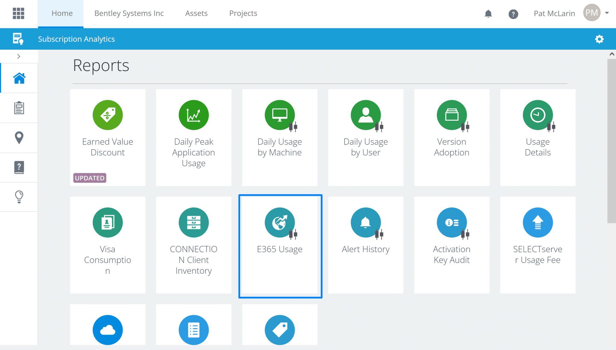

Usage reporting
- To view users, usage and spend, go to Bentley Subscription Analytics
- Select the E365 report option
![](https://www.seequent.com/wp-content/uploads/Subscription-Analytics-E365.png)

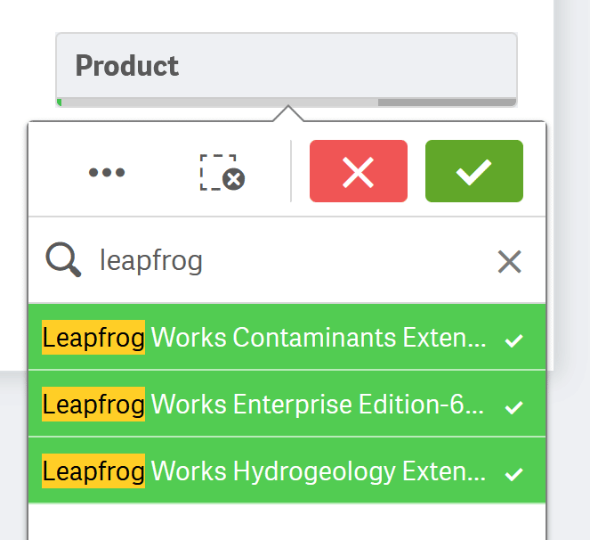

- Filter by “Leapfrog Works” to see the usage and spend on Leapfrog Works and its extensions
