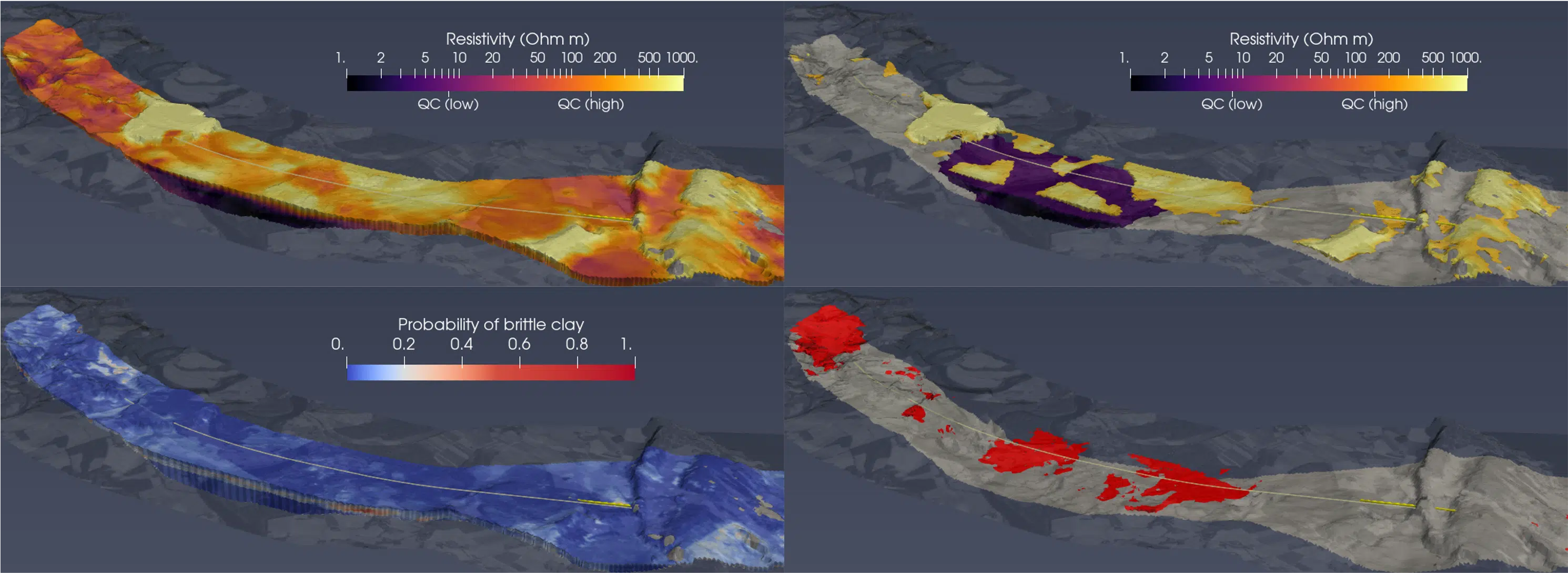

Top left: 3D volumetric grid of electrical resistivity (sediments only; material below bedrock clipped). Top right: quick clay can be ruled out based on resistivity alone where it is very high or very low. Bottom left: Computed probability of weak, sensitive clays are expected based on geophysical and geotechnical data. Bottom right: Extracted volumes where weak, sensitive clays are expected. (Image credit: EMerald Geomodelling)

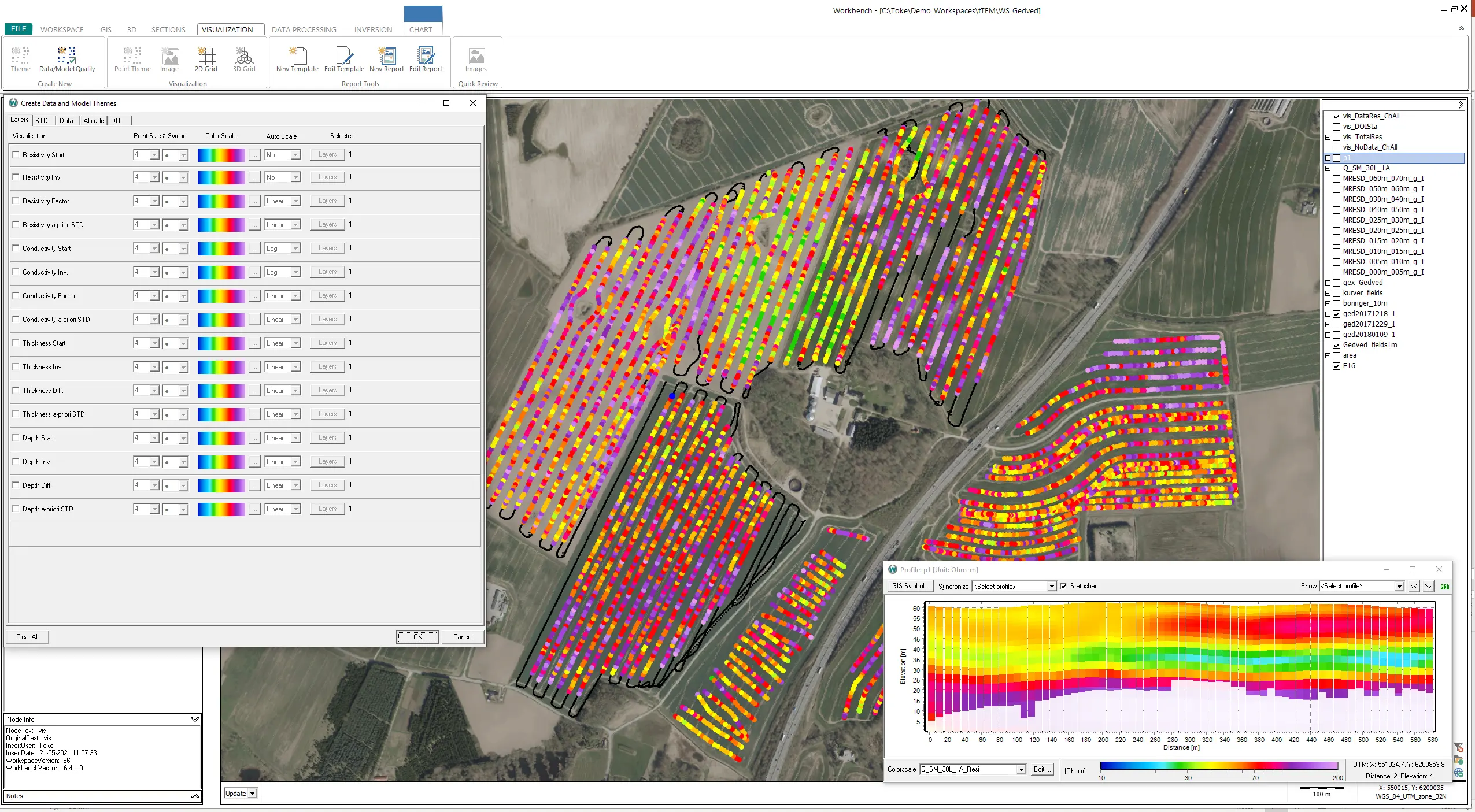

“I could plug in the SkyTEM survey data straight into Workbench and get first versions out really quickly: Get some first models, use our algorithms on them, and have a first bedrock topography fast,” says Andi.
This quickly gave the project team a clearer understanding of the underlying geology, allowing them to plan for additional data collection and to begin planning the best route.

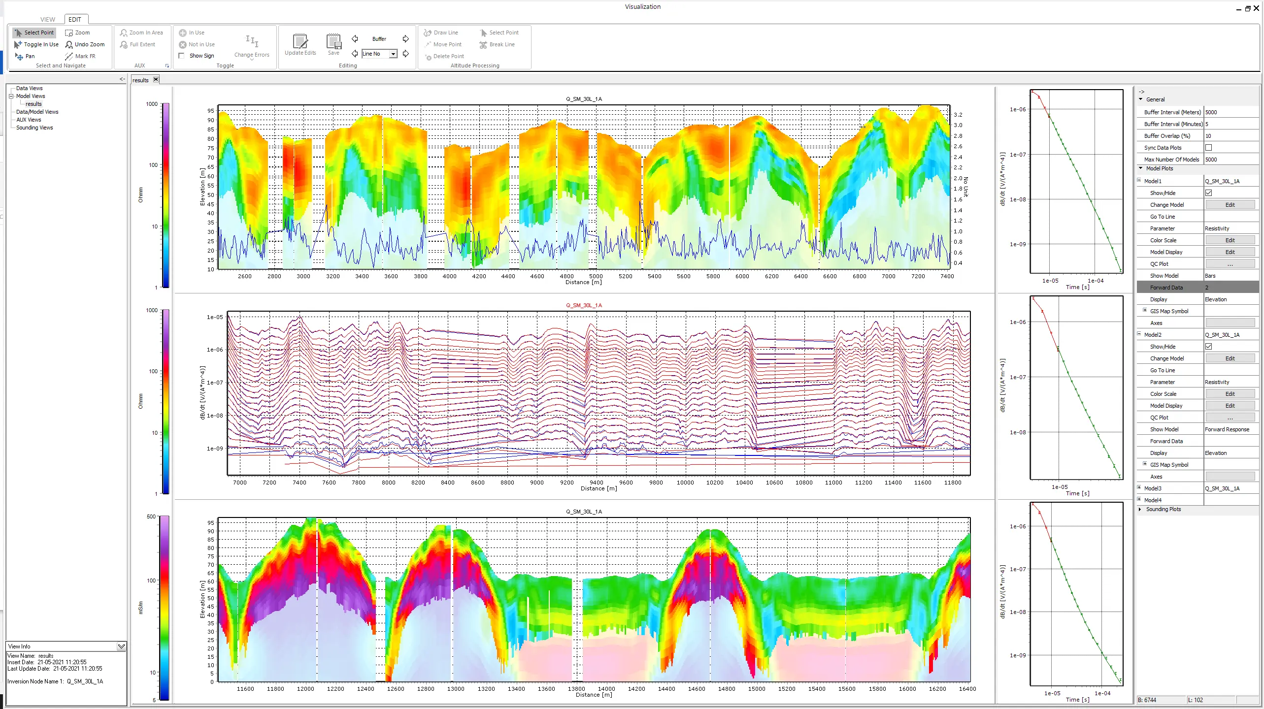

Models are only as good as the data within them. Workbench allowed the team to quality control the models made from the data and account for misfitted models and reprocessing of data.
With clean data in hand, they were able to run inversions on the data to explore the subsurface in 2D profiles and 3D grids and volumes.
 “There are quality checks you can do to see how big the misfit is between the models compared to the data. You often re-process and rerun a new inversion again, until you have models that fit the data and you’re happy with the results,” says Toke.

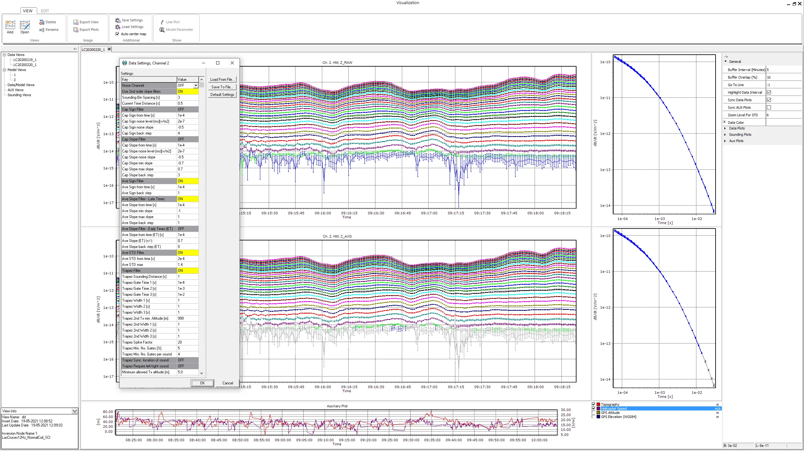

Setting processing filters to remove noise in data
Setting processing filters to remove noise in data.

Using this comprehensive bedrock model, the team could more accurately target future drilling to areas where the uncertainty was highest – and reduce it by drilling there. The more boreholes that were done, the smaller the final uncertainty in the integrated model
More importantly, they could avoid unnecessary drilling in areas where they had higher certainty about ground conditions – saving time, reducing costs, all while minimising geological risk.
“By putting the resistivity models into this neural network, you can go in and say confidently ‘This area is where the bedrock is, this is how much overburden there is, and in these areas, we need to do more investigation,’” says Andi.
