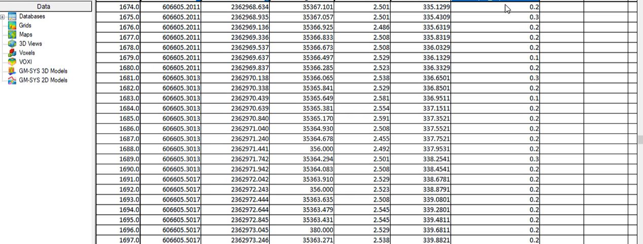

The first is using channel protection.
[00:00:40.120]
All channels are protected by default on import.
[00:00:43.510]
You can see in my database,
[00:00:44.630]
there’s a black triangle in the corner
[00:00:46.890]
of each channel header.
[00:00:48.530]
You can unprotect or protect a single channel
[00:00:51.820]
by right clicking and clicking protected.
[00:00:57.050]
You can protect none,
[00:00:59.050]
if you want to make changes to the entire database,
[00:01:02.090]
or you can protect all.
[00:01:06.290]
If you’re running a script to go through your workflow,
[00:01:08.810]
you can also add the chanprotect.gx
[00:01:12.210]
to the bottom of any script.
[00:01:13.830]
And this will automatically protect
[00:01:15.550]
all of your output channels created from the script.
[00:01:19.840]

So one way to do that is to create a new channel,
[00:01:41.900]
type the name, click okay.
[00:01:45.650]
And then select it three times,
[00:01:47.430]
click it three times so that everything is selected
[00:01:49.840]
and press the equal sign.
[00:01:51.750]
This will turn the bottom bar into a formula
[00:01:55.460]
and you can just type the name of the channel
[00:01:57.420]
that you want to copy and press enter.

If you right click on the channel name
[00:03:03.620]
and use the channel maker, that copy channel,
[00:03:06.690]
you can just reapply the last tool
[00:03:09.180]
and the same settings that were used on that channel.
[00:03:14.830]

You can highlight just the portion you want to copy back.
[00:03:40.560]
And in the database, press that equal sign
[00:03:43.110]
until you get that formula down at the bottom
[00:03:45.660]
and then press enter.
[00:03:47.140]
And you can see that what you’re actually doing here
[00:03:49.200]
is you’re restoring the original Mag channel
[00:03:52.250]
just on the portions that you’ve highlighted.
[00:03:57.530]
So you’re just highlighting it,
[00:03:58.550]
pressing equal and then enter.
