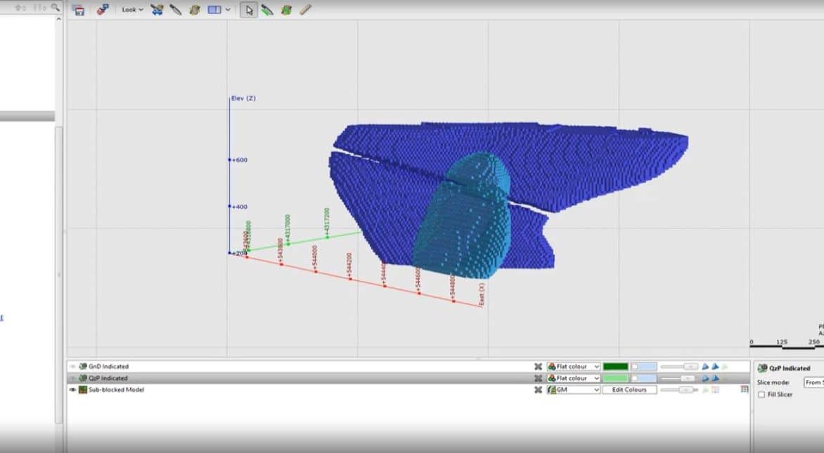

In this example here,
[00:00:30.520]
I’ve created some very crude indicated meshes
[00:00:34.280]
for the 2 domains that I’ve estimated.
[00:00:37.220]
So as you can see,
[00:00:38.670]
that they actually just overlap each other.
[00:00:41.330]
And because these domains are so close,
[00:00:43.890]
if I just use these as they were on the geological model,
[00:00:47.460]
I wouldn’t get the coding right.
[00:00:50.480]
So the way to do it, is to refine the geological model.
[00:00:53.610]
And then you can independently code each domain
[00:00:56.050]
with the relevant meshes.
[00:01:00.050]

And now I just need to evaluate this onto my block model.
[00:04:07.440]
I’ll take the classification model I’ve made.
[00:04:11.130]
Evaluate that on.
[00:04:12.435]
(light upbeat music)
[00:04:19.660]
I can just check that’s coded correctly,
[00:04:23.117]
classification model.
[00:04:26.496]
I’ll subject thing of accept.
[00:04:28.986]
[00:04:31.633]
That looks correct.
[00:04:34.910]
