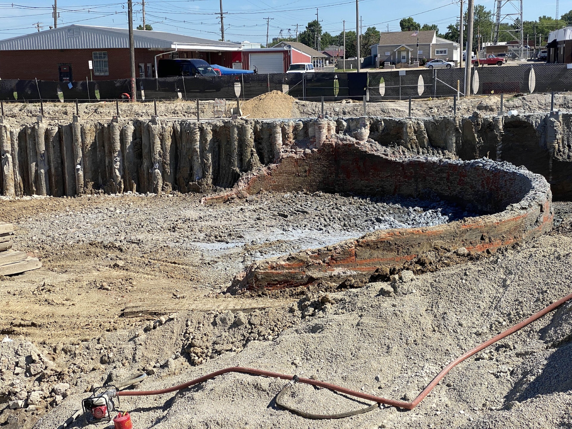

Early excavation gas holder in place
Figure 1: Early excavation gas holder in place

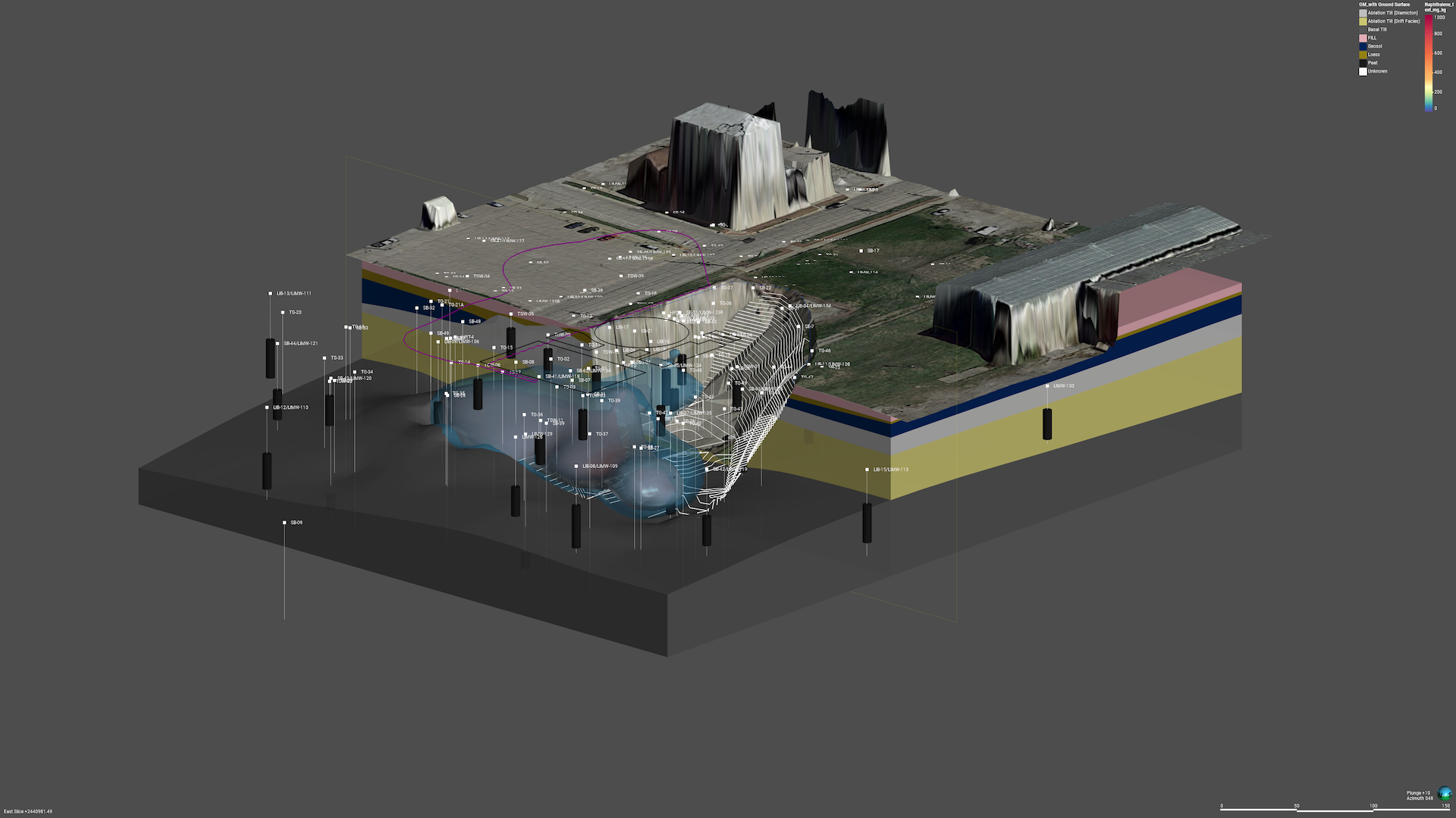

As more data was added—soil borings, monitoring wells, and electrical conductivity data—the model came to life. The different datasets aligned perfectly, revealing a clear picture of the subsurface.
Excavation and in-situ treatment areas with pre-treatment Napth plume
Figure 2: Excavation and in situ treatment areas with pre-treatment Napth plume in Leapfrog
In the model, the team could see the interaction between impacts and coarser grained ablation tills and how a tight, compact, clay-rich basal till unit acted as a groundwater barrier preventing further downward migration. This gave them immense confidence in their conceptual site model.
‘When we added extraction wells later, we were able to use this information to target their placement to maximise contaminant mass removal.’
