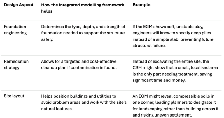

Design Aspect
How the integrated modelling framework helps
Example
Foundation engineering
Determines the type, depth, and strength of foundation needed to support the structure safely.
If the EGM shows soft, unstable clay, engineers will know to specify deep piles instead of a simple slab, preventing future structural failure.
Remediation strategy
Allows for a targeted and cost-effective cleanup plan if contamination is found.
Instead of excavating the entire site, the CSM might show that a small, localised area is the only part needing treatment, saving significant time and money.
Site layout
Helps position buildings and utilities to avoid problem areas and work with the site's natural features.
An EGM might reveal compressible soils in one corner, leading okanners to designate it for landscaping rather than building across it and risking uneven settlement.
