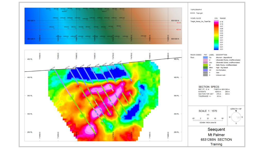

  • Import drillhole location, orientation, and interval data into Oasis montaj projects
  • Display drillholes in plan view and cross‑section alongside geophysical datasets
  • Plot lithology and downhole chemical sampling intervals against geophysical sections
  • Generate presentation‑ready drillhole sections and plan maps
