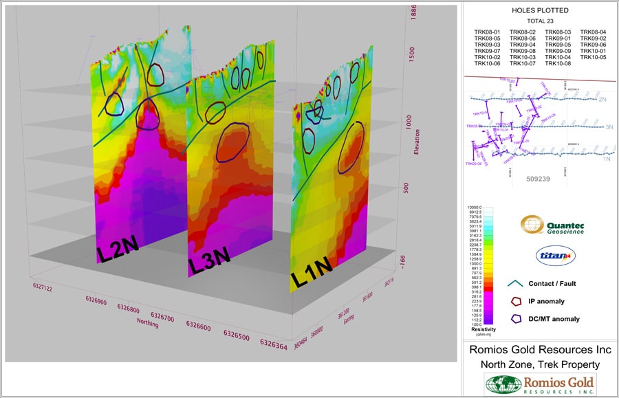

Results from Quantec’s Titan 24 geophysical survey in a Geosoft 3D View

Undertaken in the summer of 2010 close on the heels of that year’s drilling program, the Titan24 Deep Imaging’s three lines revealed what Romios had suspected. The survey identified a large deep conductor 500 by 300 by 200 metres high, across all three lines in the Trek property’s North Zone; and it still remains open to the north, east and south. As Romios Gold says on its website, “this new feature, which lies east and below the previous drilling and occurs from 500 to 675 metres below surface, represents the main target for future drilling.”
The analysis and interpretation of the DC, IP and MT results also identified several chargeable anomalies above the deep conductive zone. They were reported to coincide reasonably well with the results of the existing 23 drill holes on the North Zone. Romios intends to drill test these anomalies in its upcoming program too.

The inversion presentations were critical. “The regular DC-based inversion on the MT did a great job for the two southern lines, which indicated a conductor consistent with the geology in the area,” says Close. “Major faults overpowered the anomaly at depth on the northern line. So, applying a static shift upon the underlying resistivities to remove the influence of the overlying faults affecting this line, Quantec was able to identify the conductive anomaly striking through all three survey lines. Knowing the geology was useful for constraining the inversion.”
The final subsurface processing that brought it all together was produced using Oasis montaj. “The contouring inherent in Geosoft can histogram-equalize (evenly spread colors over a non-linear set of values) better than any other program I’ve ever used,” says Close, “so it makes incredibly beautiful maps.” He says once they had that image, they realized their drilling had just missed the conductive body. “The image confirmed what we had suspected: we had drilled smoke near the flame.”
