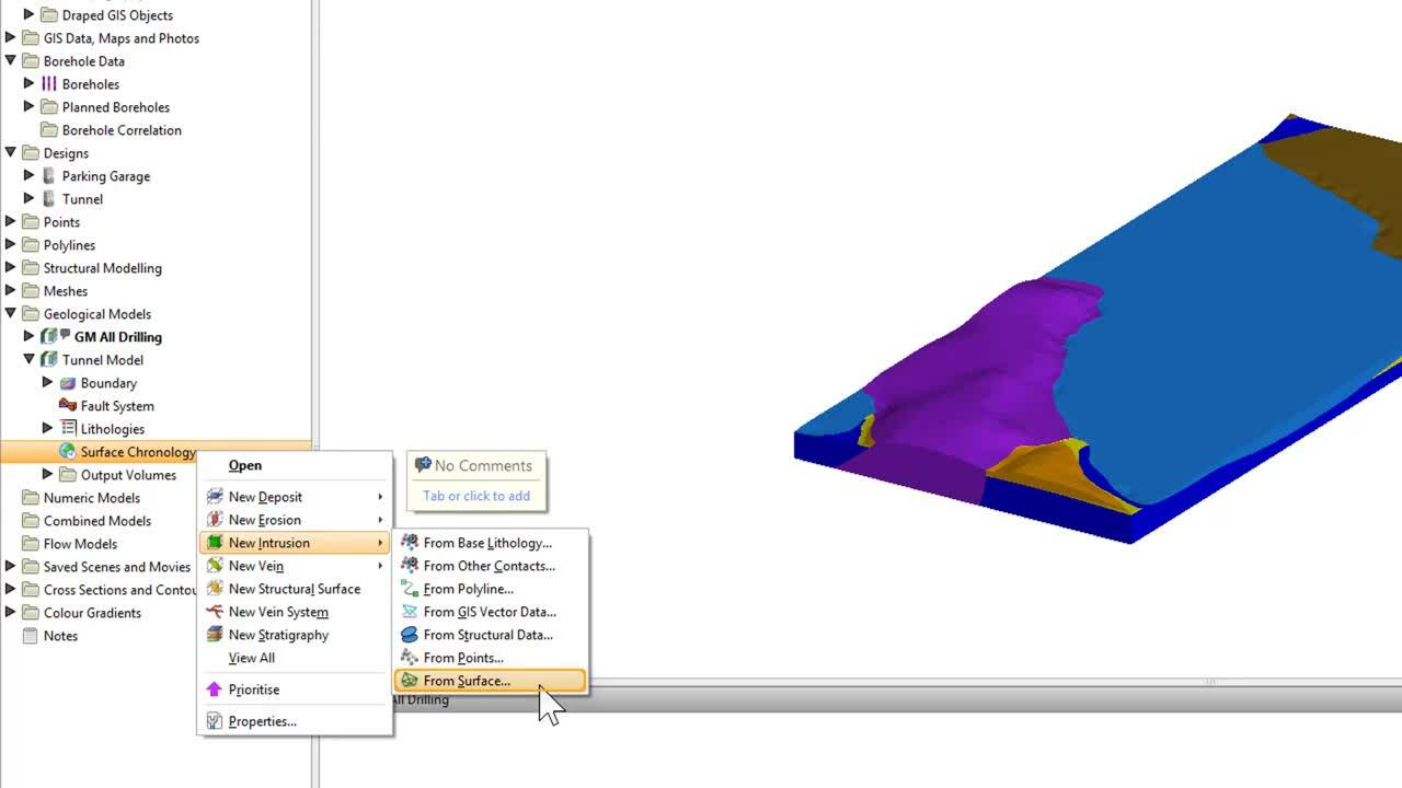

In this video, we will demonstrate how to integrate a design for the geological model, to quantify the subsurface impact of the specific design using the combined models feature in Leapfrog Works.

0:39 – Step 1 – Creating a geological model from the tunnel design
2:20 – Step 2 – Creating a new Combined Model
3:19 – Step 3 – Viewing the lithology volumes inside the tunnel design
3:32 – Step 4 – Finding the volumes for lithologies within the tunnel design
