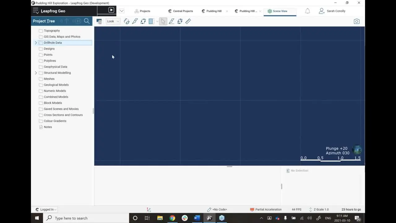

So to begin with,
[00:12:07.880]
I’m actually just in a completely blank project,
[00:12:10.240]
and I’m also going to show you another project
[00:12:12.180]
which we have already linked.
[00:12:15.740]
So, when I have a brand new project now,
[00:12:19.150]
if you guys are already using a Central,
[00:12:22.210]
you’ve probably seen this feature before,
[00:12:23.850]
but I just thought I’d demonstrate it for anyone
[00:12:26.100]
that does not have Central.
[00:12:28.150]
So, in a fresh project,
[00:12:29.660]
if I right click on the drillhole data folder,
[00:12:33.170]
there is this option to input drillholes via Central.
[00:12:39.350]
So, if I click on that one,
[00:12:40.858]
again, because my Seequent ID is linked
[00:12:44.660]
to the Central server,
[00:12:46.320]
I can see into any of the projects on that Central server.
[00:12:51.270]
I’m going to click on that Pudding hill,
[00:12:55.670]
click on the file link,
[00:12:58.920]
and you’ll see,
[00:12:59.753]
I’ll be able to see that subfolder called MX Deposit,
[00:13:03.210]
which is what Dave was looking at within the Central portal.
[00:13:06.950]
And I can see those four files that he (indistinct)
[00:13:11.360]
from MX Deposit.
[00:13:14.120]
If I open up the collar file,
[00:13:15.530]
it will automatically pick my survey, assay and lith tables.
[00:13:20.360]
And it’s just a case of then importing them.
[00:13:24.430]

If I go back to Leapfrog geo now,
[00:16:16.940]
I’ve got my model built.
[00:16:18.760]
It’s simply a case of right clicking on my drillholes,
[00:16:23.150]
reload latest file version.
[00:16:29.150]
And that’s just going to kickstart
[00:16:32.520]
the reload of my drilling.
[00:16:33.910]
So, it’s going to look to the data room,
[00:16:36.030]
it’s going to see that new file for the collar, survey,
[00:16:39.050]
assay, and lithology tables,
[00:16:41.560]
and then it’s going to go through the workflow of…
[00:16:44.920]
Look into that data.
[00:16:47.030]
I’ll reimport it,
[00:16:48.900]
and then it will dynamically update my model.
[00:16:58.110]
