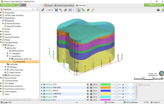

The image below is a geological model that has been refined by a polygon for the lateral extent.

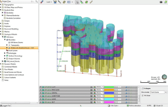

Another application is to create a lateral extent From Distance Function to refine the geological model to a certain distance away from borehole data.
Using the same model from above, the lateral extents are now shown where the model exists within 50m of borehole data.
It’s an easy option to apply and if the data changes, the model will automatically be updated. For example, if your lateral extent is defined by a distance to borehole function, then when you add new boreholes to your database, the model boundary is automatically updated. This makes updating your model with new data a breeze.
