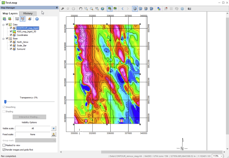

It is not uncommon for Geosoft maps (*.map) to include a geophysical grid overlayed with topographical contours as shown below:
It is possible to extract the contour data from the map to create DTM grid for better visualization.
Step 1: Sample the contour layer to a GDB
  1. Open your map and locate the contour layer in the Map Manager Tree. In the example above the contour layer is called CONTOUR_mag_bigrid
