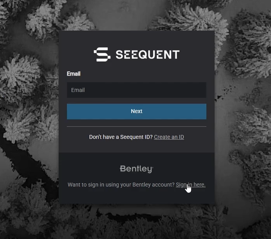

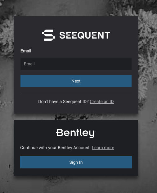

MySeequent sign in
You must sign in to MySeequent with a Bentley account at least once to access Volsung.
New users do this when signing in to MySeequent to download Volsung.
Existing users may be prompted to sign in during the in-app update or first launch.
A screenshot of the Volsung log in screen in My.Seequent
After signing in with a Bentley account, Volsung can access your licence and will open normally on future launches.
