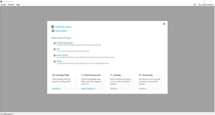

  2. The Oasis montaj project workspace opens and a Start up screen appears which enables you to quickly open an existing project or create a new one. Access is also provided for online learning resources, online support resources, training options and user forums.
3. From the Start up screen select Create new project.
The New Project dialog opens.

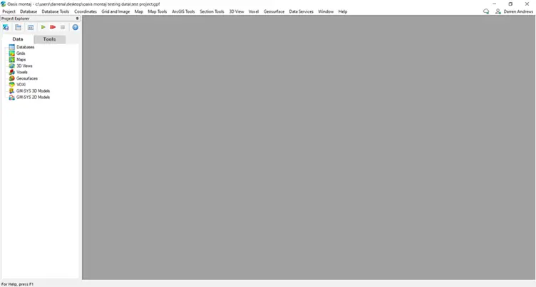

Your new project is created and the Oasis montaj workspace displays the main Oasis montaj menus and the Project Explorer, as shown below:
