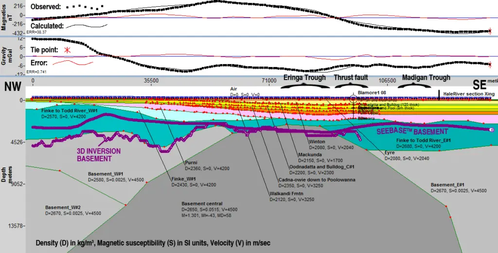

The first stage of the Blamore GM-SYS 2D profile model using a SEG-Y seismic file to delineate the shallow horizons in the time domain before converting to the depth domain for the potential field modelling.
A GM-SYS 2D profile model which includes comparative basement horizons from SEEBASE and from the magnetic VOXI inversion.

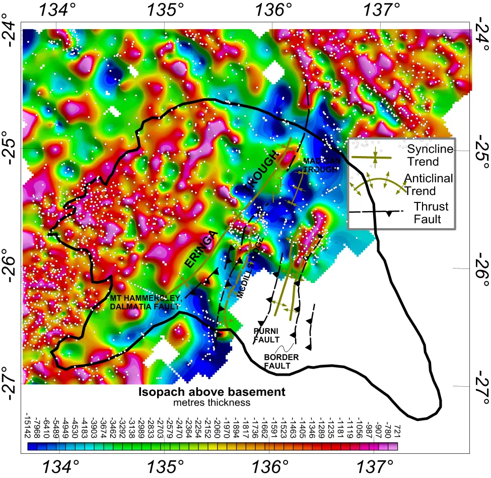

The pseudocolour grid showing the interpreted total sediment thickness (total isopach) using the GM-SYS profile model data, Euler deconvolution data and VOXI data. The sample points are the white dots. Known structures are indicated.

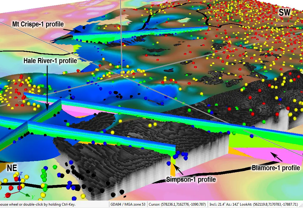

3D model map showing the GM-SYS profile sections (coloured by density), Euler deconvolution 3D symbols, pseudocolour basement grid, 3D Magnetic susceptibility voxel from the inversion of the magnetic data, coloured grey and clipped to 0.0025 SI units.
