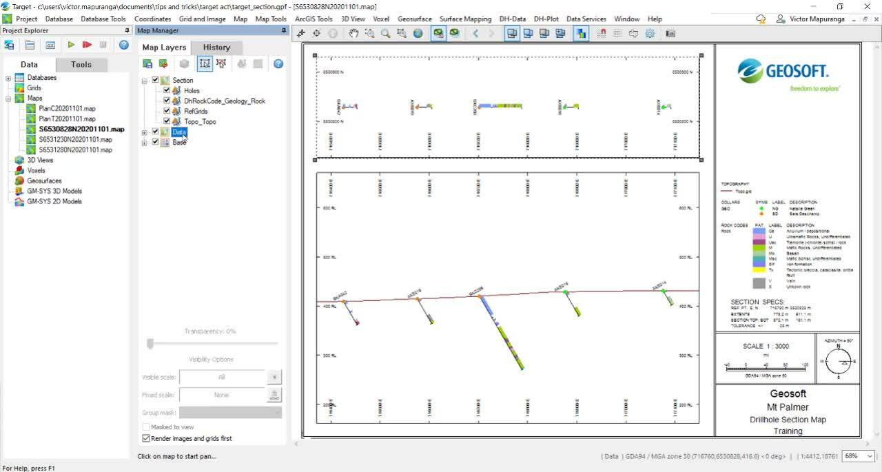

In this video, we show a workaround of how you can have similar rock code patterns
that the user would have created in a section map to also be displayed on the drillhole traces of the plan map in Target. This is a question that our users have often asked about as they way to do it is not very obvious. Knowing this trick helps the user to be in a position to present neat and presentable images to colleagues that are easy to understand for everyone.
