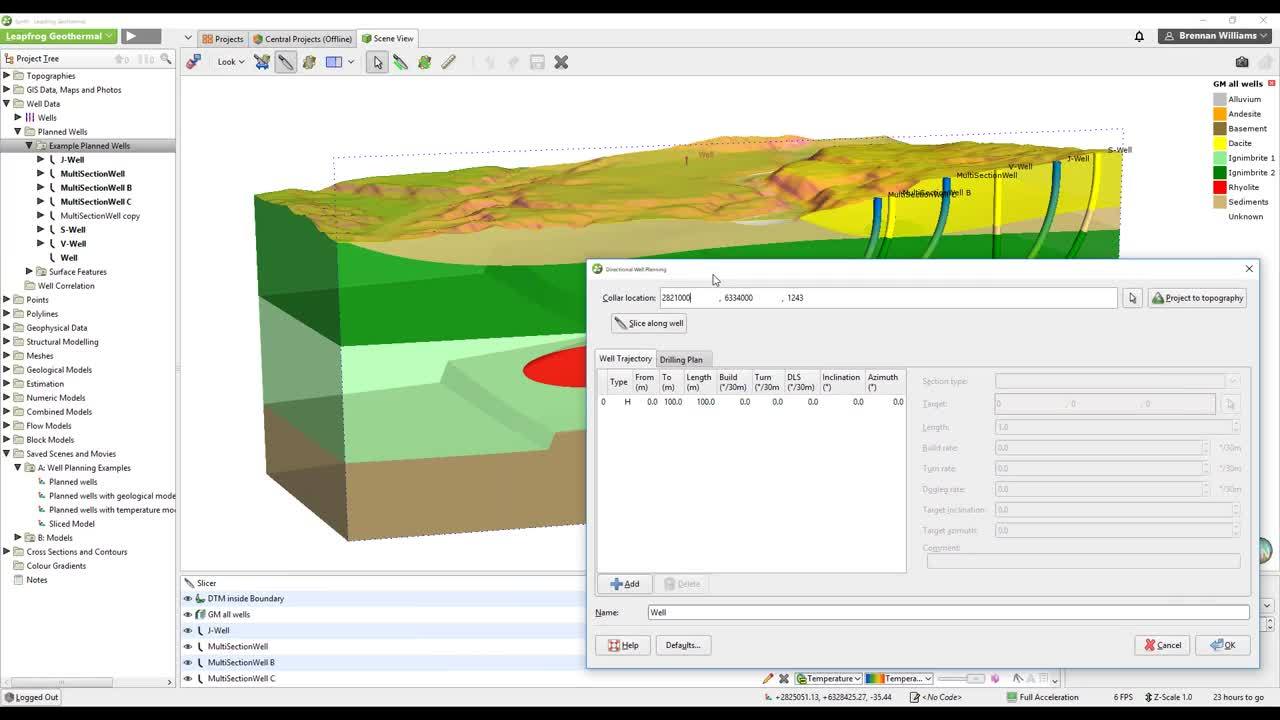

[00:04:04.620]I’ll now show you an example of interactively planning,
[00:04:08.960]a well trajectory, and what we will do as a relatively
[00:04:12.320]simple S-shaped well over in this part of the reservoir.
[00:04:18.530]Right click and select plan direction well,
[00:04:21.290]this brings up the direction of well plan in dialogue.
[00:04:24.900]The first thing you need
[00:04:25.733]to do is to find the collar location.
[00:04:27.910]You might find it useful to display
[00:04:31.360]the topographical surface and to select face step,
[00:04:37.370]and you might also find it useful to use a color range
[00:04:41.390]whereby you can set a tolerance
[00:04:44.240]in this example of five degrees,
[00:04:46.710]so everything colored green has got a dip
[00:04:50.000]of less than five degrees, and so it’s relatively flat
[00:04:53.043]for a top location for the well.
[00:04:58.110]So, let’s say I will project over here
[00:05:04.100]and that’s my start point,
[00:05:05.660]I have an initial hold of a hundred meters.
[00:05:08.510]Lets increase this down to 200 meters.
[00:05:12.813]We now going to add the build section,
[00:05:16.100]so on the right-hand side here in my six
[00:05:18.210]available section types, I’ve started with a hold,
[00:05:22.190]now I want to build and I’m going to build to target,
[00:05:25.960]I click on the arrow here, come back into the scene
[00:05:29.570]and go right I’m going to build to the target here.
[00:05:36.020]This calculates my required build and turn rate
[00:05:39.300]as I’m working in a plane, my turn rate is zero.
[00:05:45.600]Now, I want to add an additional hold
[00:05:48.650]and then drop in order to create my S shape.
[00:05:52.730]Again, hold and drop is to a target end of section
[00:05:56.850]which you specify in the scene,
[00:05:58.930]so I’m going to hold and then I’m going to drop down to here.
[00:06:05.030]You notice that I’ve got to calculate a dogleg right,
[00:06:07.580]that I can increase or decrease,
[00:06:10.150]so as I increase that it will shorten the drop section
[00:06:17.610]which is effectively a build with a negative build rate,
[00:06:21.110]and it will increase the hold section.
[00:06:23.690]Once I’m happy with the trajectory of my well,
[00:06:27.000]I can check my drilling plan which would be exported
[00:06:30.210]out to the drilling plan CSB far.
[00:06:33.000]This has got columns for measured depth down the trajectory,
[00:06:36.520]the inclination hasn’t met the TBD SS
[00:06:40.640]north, south, east, west offsets the absolute offset
[00:06:43.770]my build and turn rate, my dog licks off severity rate,
[00:06:47.120]and my absolute North, East and elevation
[00:06:49.800]for the points down the sections.
[00:06:53.120]If I’m happy with that lets give it a well name,
[00:06:58.401]call it S well two then click okay to save it.
