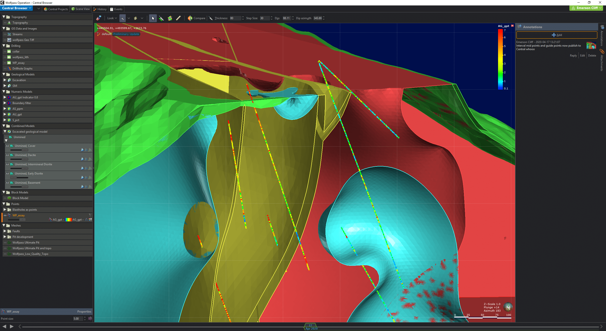

[00:01:41.680]In Central 3.1 we’ve made improvements to the data room,
[00:01:45.410]being able to navigate and move data with greater ease,
[00:01:48.380]upload files without a limitation size,
[00:01:51.100]guide and midpoints are now enabled
[00:01:53.280]to be published to the Central browser,
[00:01:56.200]and now the Central browser is backwards compatible
[00:01:58.870]with older versions of Central up to version 2.3.
[00:02:02.740]Connecting to Central cloud-hosted instances
[00:02:05.440]is now even easier through a common port.
