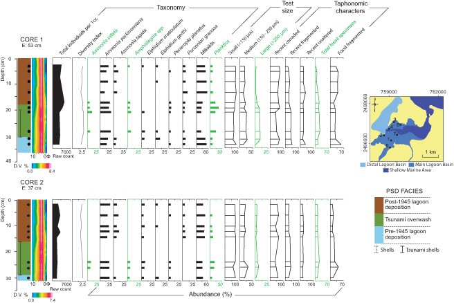

Identifying and characterizing the 1945 Makran tsunami in Sur Lagoon, Oman.  Particle Size Distribution (PSD) plots created in Geosoft Oasis were used to detect subtle differences between tsunami overwash and normal lagoon sediments.  Species of foraminifera, along with their test (shell) size and condition, support particle size findings and provide additional insight into the source of sediment (e.g., offshore).  (Source:  Pilarczyk, J.E., Reinhardt, E.G., 2012. Testing foraminiferal taphonomy as a tsunami indicator in a shallow arid system lagoon: Sur, Sultanate of Oman.  Marine Geology 295-298, 128-136.)

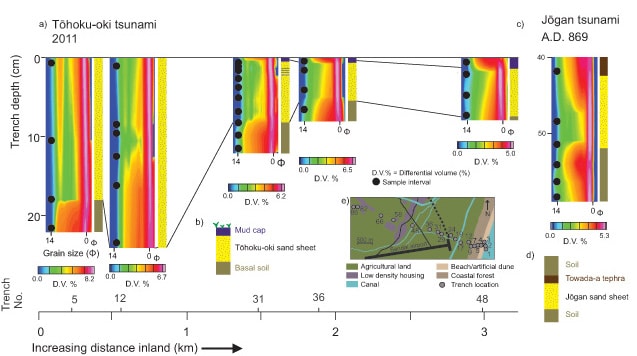

A comparison between the 2011 Tohoku-oku and A.D. 869 Jogan tsunami desposits in Japan.  PSDs highlight key similarities (and differences) between the two tsunamis and reinforce that both were of similar magnitude; the 2011 Tohoku-oki tsunami, the largest tsunami ever recorded, in fact had a predecessor.  (Source:  Pilarczyk, J.E., Horton, B.P., Witter, R.C., Vane, C.H., Goff, J., Chagué-Goff, C., 2012. Sedimentary and foraminiferal evidence of the 2011 Tohoku-oki tsunami on the Sendai coastal plain, Japan. Sedimentary Geology 282, 78-89.)

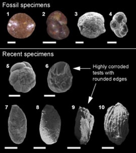

Scanning Electron Microscope (SEM) images of foraminifera indicating varying test (shell) condition.  Fossil and unaltered (e.g., no evidence of corrosion and abrasion) foraminifera are indicators of tsunami overwash.
