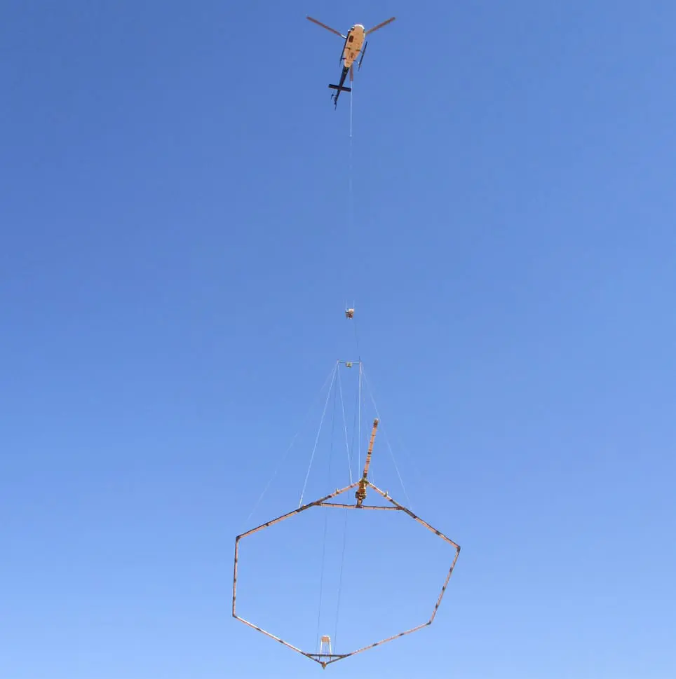

Airborne surveys use a technology called TimeDomain Electromagnetics, which involves creating an electromagnetic signal that varies with time.
Equipment that resembles an extremely large hoola-hoop is towed under a helicopter as it flies about 100m (328 feet) above the ground. The equipment transmits an electromagnetic signal into the earth and depending on how resistive or conductive the earth is, we can use the returned signal to infer the nature of the subsurface.
Rocks will have different physical properties that will affect how the current flows, and that can tell us, for example, if there are clays or unconsolidated sediments present.
In the geophysical processing and modelling of the result we can derive a pretty realistic earth model of what is below our feet, and from that we can work with a team of geoscientists to assemble a hydrogeological model based on the resistivities and other known rock properties.
Time Domain Electromagnetic surveying (TDEM) uses induction to measure the electrical conductivity of the subsurface. The primary magnetic field created from a transmitter coil generates eddy currents in conducting bodies (including those beneath the surface). A receiver coil measures the secondary magnetic field from the subsurface, and it’s this that helps geoscientists establish the nature of the subsurface conductor.

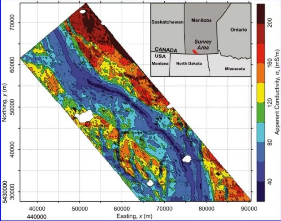

Figure 1.
Figure 1 is from one of the first groundwater focused airborne Time Domain EM surveys done in Canada (2010). The image represents a depth slice through the earth 75m (246 feet) below the surface. The areas that are blue represent the buried valley and aquifer material. The areas that are red represent boundaries, interfluves, and nonaquifer material. Needless to say, the geophysical model is not only mapping the main extents and boundary of the Spiritwood aquifer, but all of the small deviations and interplay of the aquifer in the southern part project area. This type of detail would be impossible to achieve without aid of geophysical mapping.
