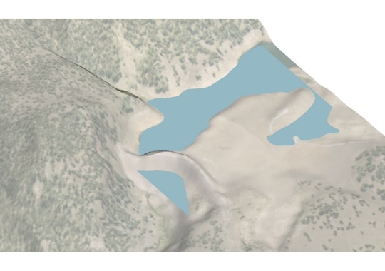

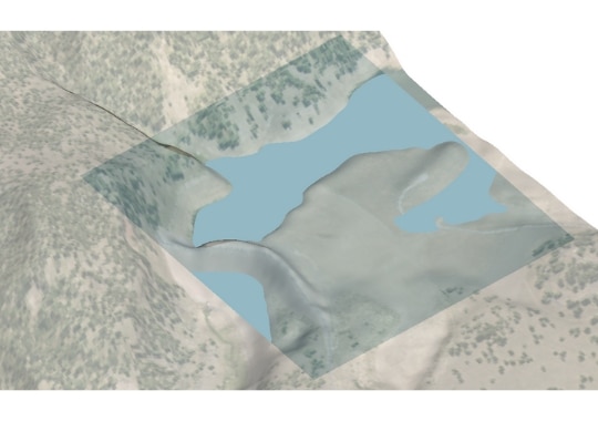

In the below example there is a water level surface and a topography that didn’t take water level into account. Because the water level surface was relevant to this project, then we want to clip the water level surface to the topography. This will allow you to create a water surface for the Dam that is confined by the topography with proper shoreline boundaries at the water level elevation.
Before:
After:

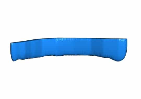

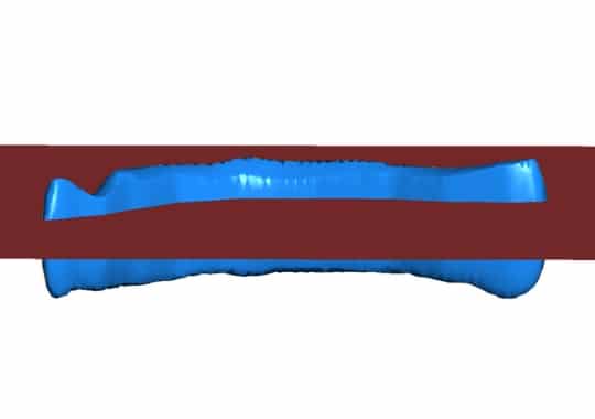

For the following example, there was an output volume of current Earthen Dam material in place and an unclosed mesh representing the top elevation of the Dam’s design plan. In order to model the final Dam volume, you can use the clip volume operation to remove the excess material above the desired Dam surface.
Before:
After:

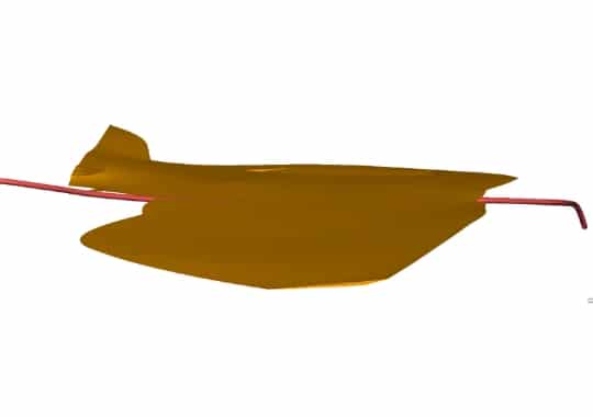

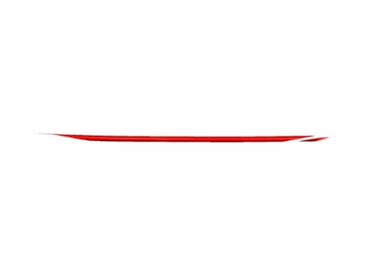

You can use this tool to join and separate volumes. It can be used as a ‘cookie cutter’ or to assign two separate volumes as one. In the following example, a mesh was extracted from a CAD tunnel design in Leapfrog. You can use the mesh of the tunnel as a cookie cutter to create a volume and see exactly where the tunnel would be going through a particular type of lithology at the site – for example, where the tunnel would intersect silt. This was then used to ensure the tunnel sections were constructed according to the different lithologies they cut through.
Before:
After:
