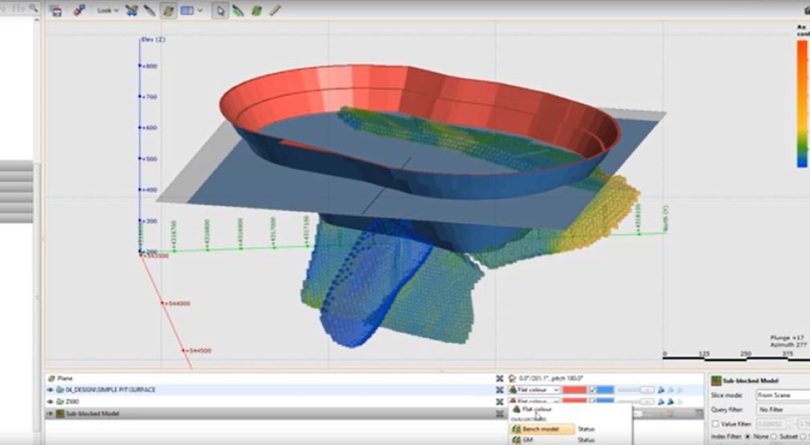

[00:01:33.360]So to create the levels for the contacts
[00:01:37.140]for the Bench model,
[00:01:38.420]I’ve been doing that using the moving plane.
[00:01:42.170]So just draw a moving plane into your scene somewhere,
[00:01:46.920]and then you can always adjust the dip
[00:01:50.195]into your figure.
[00:01:51.028]So that’s making sure that it’s completely flat.
[00:01:53.270]And then my Z, I need that at 690,
[00:01:57.981]then I come to meshes for a moving plane.
[00:02:02.730]I’ll just call that Z690, okay.
[00:02:09.073]So you see that’s created a mesh exactly on that level
[00:02:13.300]that I want.

[00:02:54.128]And all you have to do is evaluate that
[00:02:56.260]onto your block model.
[00:02:58.830]So there’s my Bench model valuated on.
[00:03:02.890]You may want to use it as a sub-blocking trigger as well,
[00:03:06.270]just leave it like that for now.
[00:03:08.300]So while that’s doing that,
[00:03:10.600]I will show you what this model looks like.
[00:03:17.210]So you can see that the model is in 60 meter Benches
[00:03:21.040]to correspond with my pit here
[00:03:23.240]and everything below 450 I’ve just left, it’s quite thick,
[00:03:28.640]but everything else is in regular intervals.
[00:03:36.384]So here’s my model,
[00:03:38.420]my actual estimated model
[00:03:43.900]coded by Bench.
[00:03:47.640]There we go.
