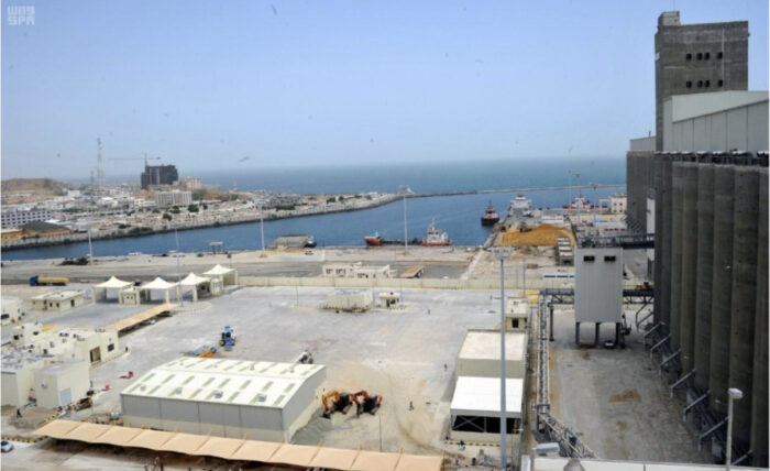

In the humming Saudi Arabian port city of Jazan, on the Red Sea, grain trucks now rumble through a huge warehouse that once seemed doomed almost from the start.
By Sean O’Neil
Years before the building was completed, around 2017, cracks laced its concrete slab, walls, and joints. Uneven settlement warped the floor and walls. When heavy cargoes of grain arrived, the damage accelerated. Why had the foundations failed so spectacularly?

The food security warehouse (bottom left) at Jazan City Port that was saved by GeoStruXer using Bentley and Seequent software. Source: Supplied

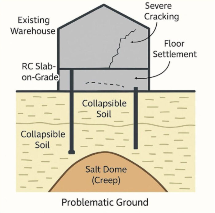

If ever a region existed to test the thesis, it is Jazan. The city sits on what’s known as sabkha soil, salt-rich coastal flats that can not only collapse but also corrode foundations. Seismicity and extreme heat only compound the risk. ‘An old note by the U.S. Geological Survey team suggested that Jazan better be evacuated and rebuilt virtually anywhere else,’ Al-Hashemi points out.
By the time the facility at Jazan Port had been completed in 2017, the beleaguered structure showed 170 millimetres (6.7 inches) of differential deformation, or uneven settling, throughout the years. Unfortunately for GeoStruXer, the owner had no reliable historical data as to how this settlement had progressed. The owner had commissioned four soil reports, but they all conflicted with each other, and none came close to explaining the magnitude of the deformation.
Al-Hashemi fed the most pessimistic soil data into PLAXIS 3D, Seequent’s advanced 3D software that lets engineers model how soil, foundations, and structures interact. The model couldn’t fully explain the problem, accounting for just a portion of the 170 millimeters observed. ‘There had to be something else, some time-dependent process,’ he recalls. Reviewing old geological reports, he made a key discovery: The entire warehouse region was above a 5-kilometre salt dome – a vast body of ancient rock salt that moves, deforms, and dissolves when it meets groundwater, quietly dragging everything above it out of alignment.
It was a big problem. ‘Once encountered, you cannot “solve” a salt dome; you cannot overcome it. You have to live with it,’ says Al-Hashemi. ‘But you have to understand how it is behaving.’ And when a salt dome starts dissolving and forms an underground cavity, it will gradually swallow the sand above it.

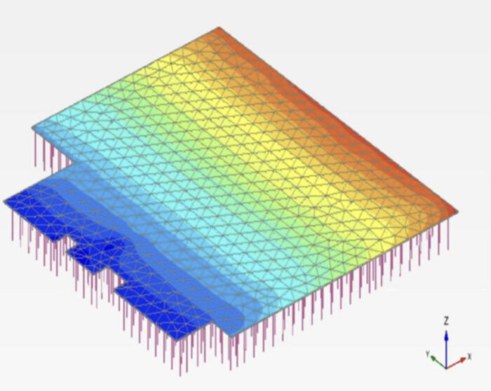

A PLAXIS 3D model showing the extent of the expected temporary deformation of the completed foundation design in the event of an earthquake.

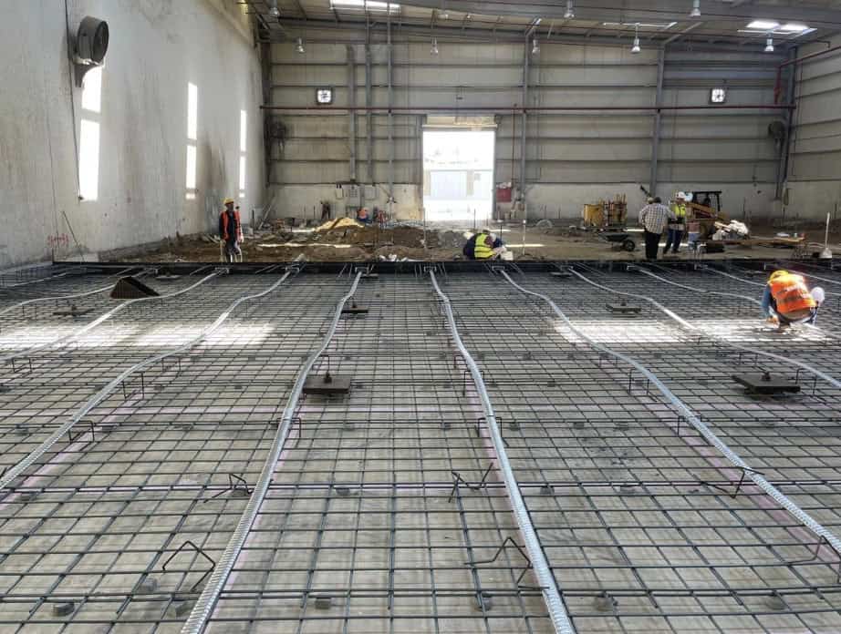

With the ground model validated, attention turned to the structure- Al-Faleyleh’s domain. Her solution, designed using Bentley’s RAM Concept software, was to pair and evaluate the micropiled foundation with a new post-tensioned concrete raft. This system is stronger and thinner than a conventional slab thanks to high-strength steel tendons tensioned after the concrete is poured. Typically, in such designs, rafts are treated as ‘floating’ on the foundations, carrying little of the structural load. But thanks to GeoStruXer’s final validated ground model, Al-Faleyleh could safely design a system where the micropile foundations and raft shared the load roughly 70/30, reducing materials and boosting sustainability without compromising performance.
Preparing to pour the concrete slab around the steel cables that would then be tensioned. The square plates each sit atop a micropile. Source: Supplied
