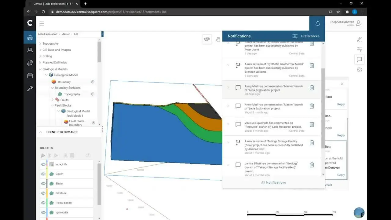

So here we are in the Central Portal,
[00:03:56.260]
and I’ve just launched up Google Chrome here.
[00:04:00.240]
And I’m viewing a model
[00:04:03.090]
that’s already being published to Central.
[00:04:06.330]
So this is a new feature of Central 4.0, web-base.
[00:04:10.430]
And what it means is that we can bring on other team members
[00:04:14.270]
or non-technical people
[00:04:16.220]
to communicate our modeling decisions
[00:04:18.890]
without them having to download another piece of software,
[00:04:21.710]
another application.
[00:04:24.450]
The real power is through comments.
[00:04:27.900]
So I can open my comments up here on the right-hand side.
[00:04:33.317]
And I can an add a comment to this model
[00:04:36.680]
if I wanted to review a particular drill hole
[00:04:40.680]
or a section here.
[00:04:44.040]
In addition to just being able to add comments
[00:04:46.300]
like in, I had to mention particular colleagues,
[00:04:49.800]
which is then going to send them a notification
[00:04:54.230]
to bring them directly into the loop.
[00:04:58.210]
But you can see here,
[00:04:59.070]
I’ve already got this comments panel open.
[00:05:00.890]
I’ve got a few comments that I’ve been made
[00:05:03.680]
onto this particular model revision in the cloud.
[00:05:07.340]
I can simply click on the thumbnail
[00:05:09.450]
associated with that comment to load up those same objects
[00:05:13.160]
that that person had loaded at the time.
[00:05:17.500]

So web visualization can be accessed in a few ways.
[00:06:35.570]
You can either send a link, as I mentioned before,
[00:06:39.520]
or I’d mentioned, if you were tagged in a comment,
[00:06:43.390]
you’d receive an email and an in-app notification.
[00:06:47.630]
So our notifications panel has been improved
[00:06:49.890]
and its access through the portal with this bell icon here.
[00:06:54.460]
And you can see I’ve got a few notifications.
[00:06:58.460]
Any of these relating to a comment,
[00:07:01.850]
I can simply click on that
[00:07:03.660]
and it’s going to take me to the project
[00:07:05.840]
that that comment relates to.
[00:07:07.700]
And again, straight into the web visualization.
[00:07:15.190]

I can also visualize our data in the Central Browser
[00:09:25.730]
and add comments,
[00:09:30.810]
but if you were wanting to consume some information
[00:09:34.060]
directly from the browser, you can do that too,
[00:09:37.030]
such as if you had a customer of your geological model,
[00:09:40.750]
that wanted to be kept up to date with the latest version,
[00:09:44.060]
they could subscribe to that project
[00:09:45.620]
to receive the notifications
[00:09:47.250]
and then come into the Central Browser
[00:09:49.390]
and simply right click
[00:09:50.920]
on some of these geological modeling objects
[00:09:53.650]
and export those.
[00:09:56.260]
We can export into a variety of formats as well,
[00:09:59.720]
including common mining formats, DXF data mining files.
[00:10:10.430]

downloaded and opened.
[00:10:40.130]
So those annotations that my colleagues were making
[00:10:43.160]
in web visualization or through the Central Browser,
[00:10:47.240]
they don’t just get stuck into a database
[00:10:50.080]
and not used.
[00:10:51.500]
I, as a modeler, could review those comments up here
[00:10:54.040]
in the top right panel
[00:10:56.750]
and I can to load up again, any of these scenes.
[00:10:59.670]
So for instance,
[00:11:01.300]
Jenina here is asking to review a thickness
[00:11:04.130]
of a particular modeling object.
[00:11:06.320]
I could click on the thumbnail associated with that comment
[00:11:10.610]
load all those objects,
[00:11:13.300]
and then they’re going to be loaded up in Leapfrog Geo
[00:11:16.690]
with that geo tag placed exactly where the conversation
[00:11:20.390]
that I was referring to.
[00:11:23.528]
So I can come into Leapfrog Geo,
[00:11:25.830]
make any necessary edits that I need to the model,
[00:11:29.190]
hop back onto the Central Project tab,
[00:11:32.790]
and then reply to that comment to mark it off as complete
[00:11:36.090]
or continue that discussion and tag someone else
[00:11:39.160]
that needs to action something with that model.
[00:11:43.300]
