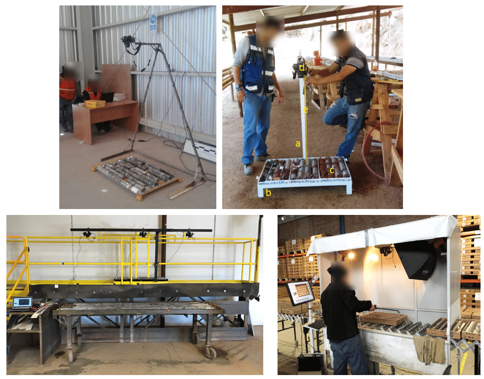

Image Quality.  If your organization is taking pictures of drill core without an imaging station, the image quality will suffer and vary widely between images.  An imaging station is basically an enclosure or stand that can hold the camera and lighting in a fixed position relative to the drill core below it, so that every picture taken uses the same lighting and distance.  Here’s a good article about the 2 main types of imaging stations, which you can easily build yourself for very little cost.
