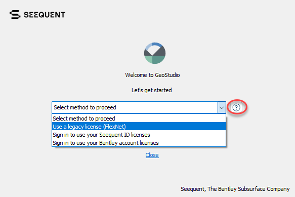

3. If you don’t have GeoStudio installed already, it is available from the Bentley Software Downloads Page.

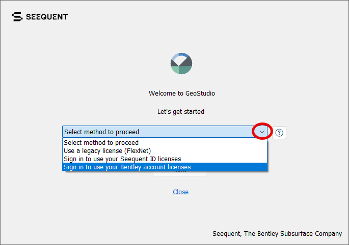

4. Open GeoStudio and sign in using your Bentley Account licenses option.

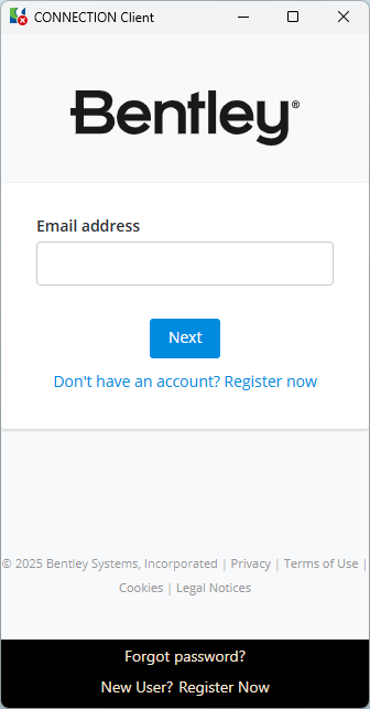

If you are not logged into the Subscription Entitlement Service, the Connection Client will pop up and prompt you to login.
  • 5. Enter the email associated with your Bentley account, or click on your email if it is displayed, and follow login instructions.
  • 6. If the Connection Client does not pop up, you can find and click the Connection Client logo in the system tray. If you are signed out, there will be a red X next to the Connection Client logo. Click on the Connection Client logo and select Open.
  • 7. Enter your Connection credentials and login. After logging in, you will see a green check next to the Connection Client logo indicating you are logged in.

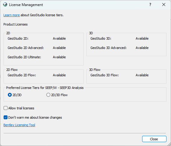

  • 8. When in the Bentley License System, you will see the license management window.
  • 9. More information about each tier can be found by visiting the link provided in the dialogue.

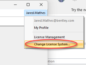

  • 10. The Change License System dialogue can be used to switch between license systems at any time, as long as there are no active GeoStudio files open.
  • 11. The question mark beside the dropdown menu describes the different license systems
