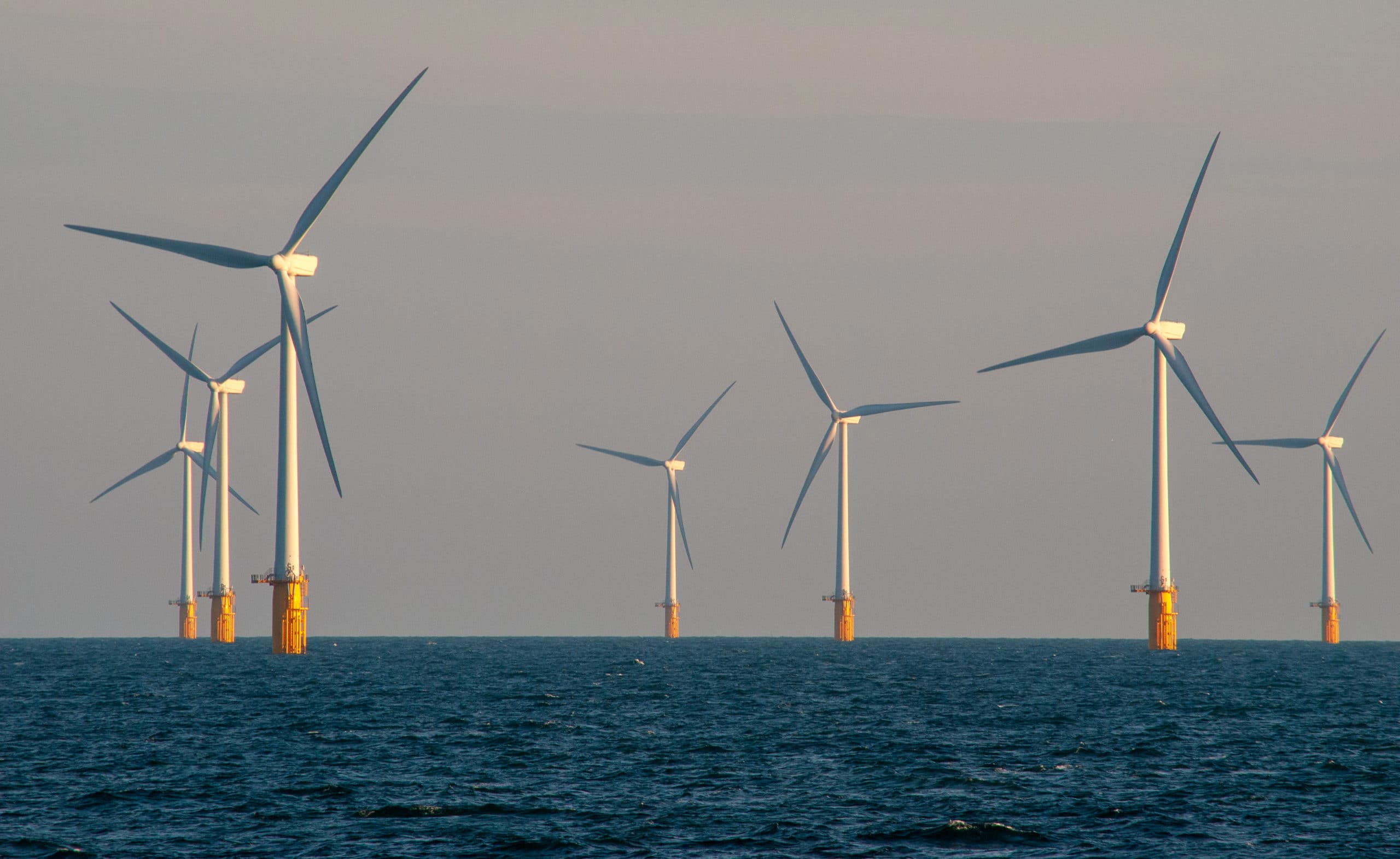

When it comes to non-conventional renewable energy, the British Isles are a world leader. Consider the current boom in offshore wind farm projects fueled by the UK’s strong coastal winds. To extract energy from the wind, enormous turbine towers are built based on a detailed understanding of the seabed at proposed sites. It’s little wonder, then, that companies like Bibby HydroMap are seeing a growth in demand for undersea surveys.
