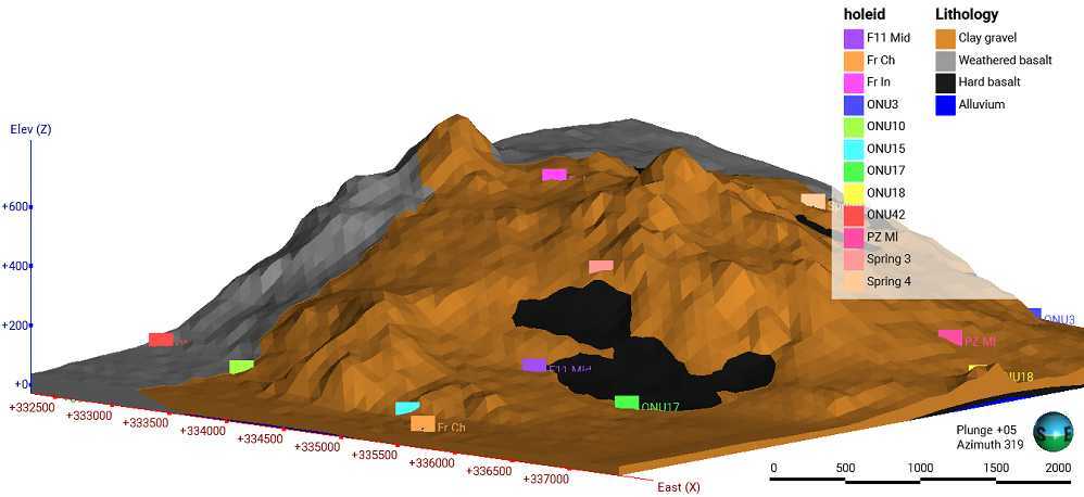

A 3D geological model displaying terrain elevation, lithology layers—including clay gravel, weathered basalt, and hard basalt—and labeled drill hole locations.
Figure 2: 3D geology of Badjini massif
