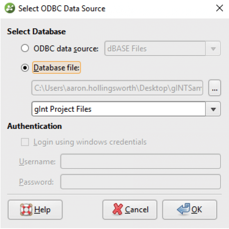

Now when the Select ODBC Data Source window appears, make sure gINT Project Files is selected under database file.

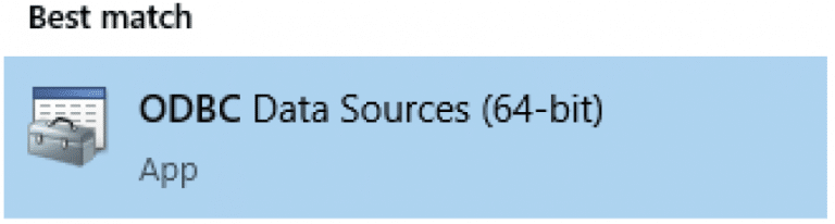

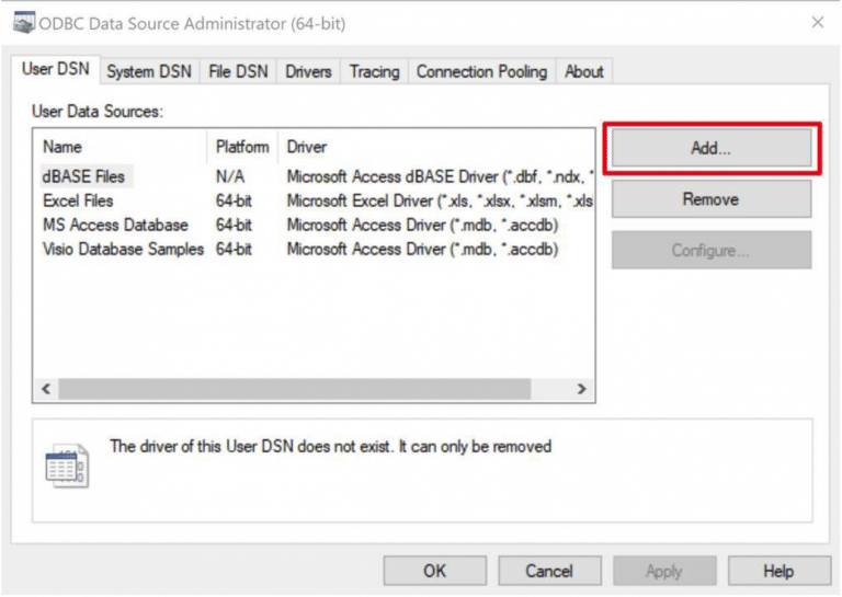

To do so, open the ODBC Data Source (64-bit) window and create a new User Data Source, this can be found by going to the Windows Search bar and typing in ‘ODBC Data Source’.
In the ODBC Data Source window, click Add.

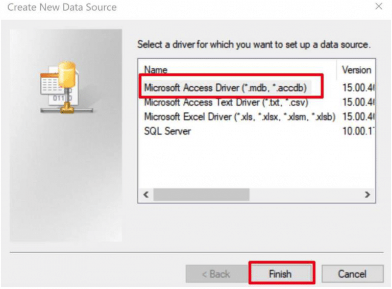

In the pop-up window, select ‘Microsoft Access Driver (.mdb, .accdb)’ and click Finish.

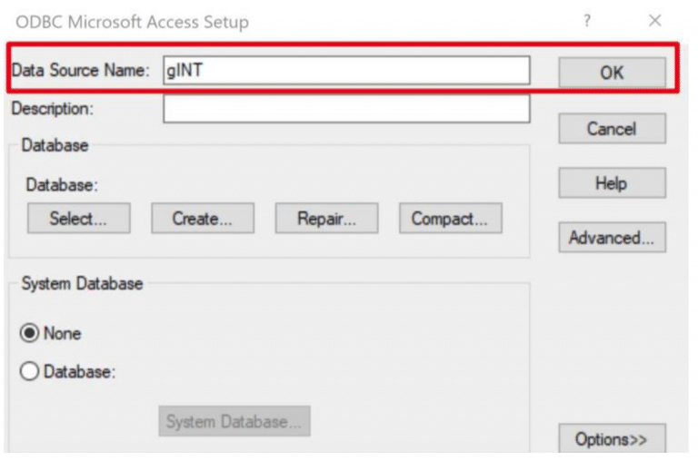

In the next window, set the Data Source Name to ‘gINT’ and click OK.
This new gINT data source should now appear in the user data source name tab in the ODBC Data Source window.

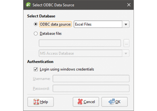

1) Selecting Database:
You will have the option to select an ODBC data source or a Database file to import your borehole data.
Selecting ODBC data source will give you the option to select Excel Files or a MS Access Database.
Selecting Database file will enable you to locate the files on your computer and allow you to designate them as Access Database (*.mdb, *.accdb), gINT Project (*.gpj), or Excel files.

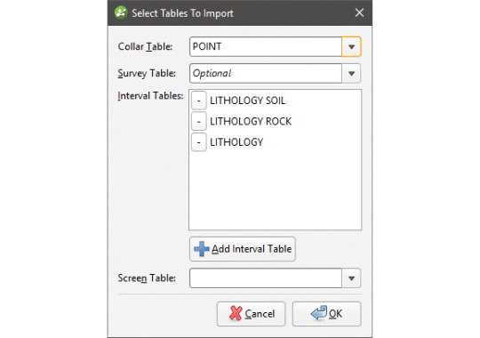

Leapfrog Works will select the collar, survey and interval tables from the data in the file, which is displayed in the Select Tables to Import window:
Click on the Collar Table, Survey Table and Screen Table dropdown lists to select from the data available in the file.

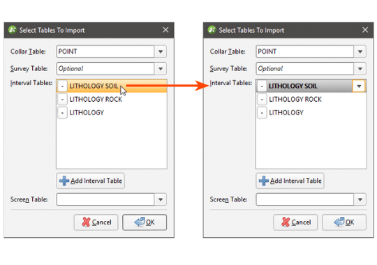

To change one of the ‘Interval Tables’ to a different column in the file, click on the table name to highlight it, then click to the right of the column name to activate the dropdown list:

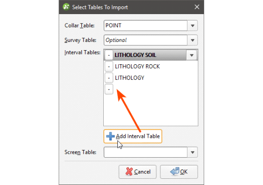

To add an interval table, click the Add Interval Table button. A – button will be added to the Interval Tables list.

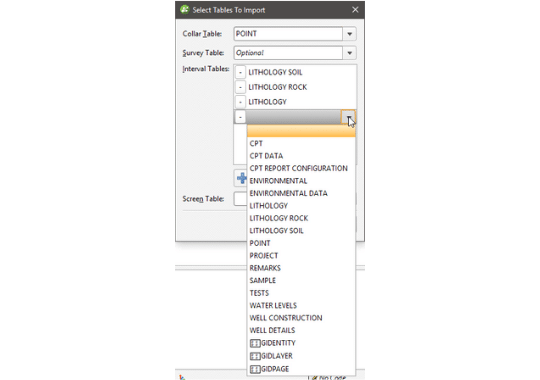

Click on the blank space to highlight it, then click to the right of the column name to activate the dropdown list:
